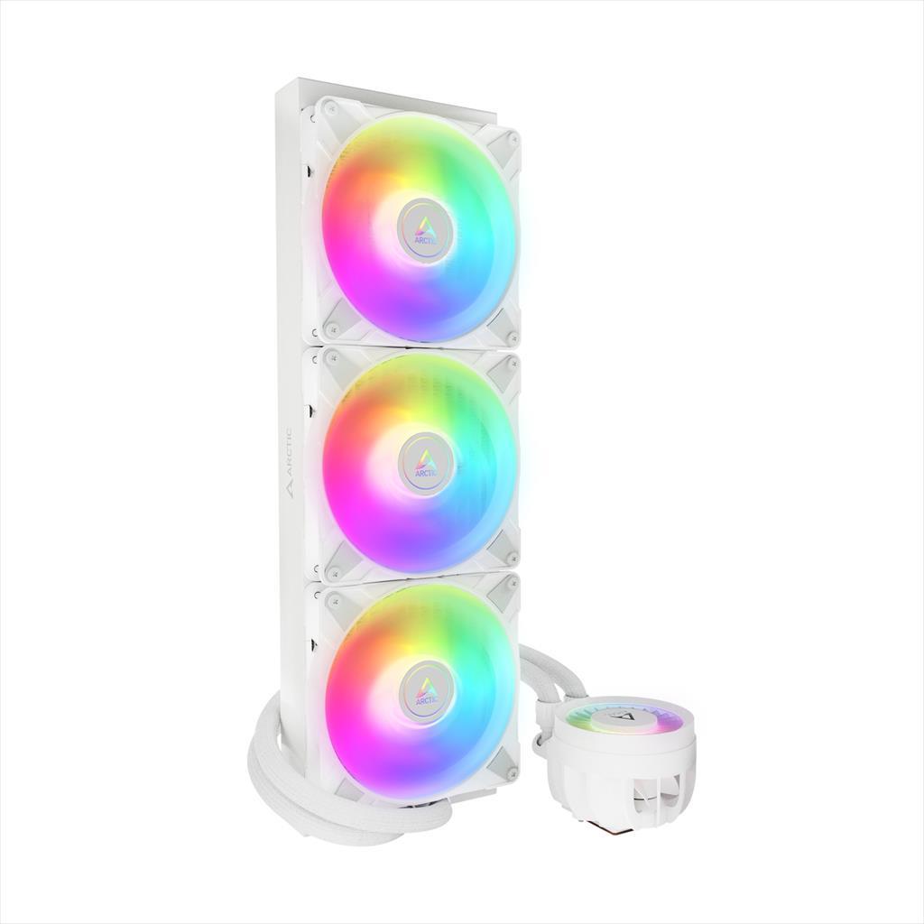

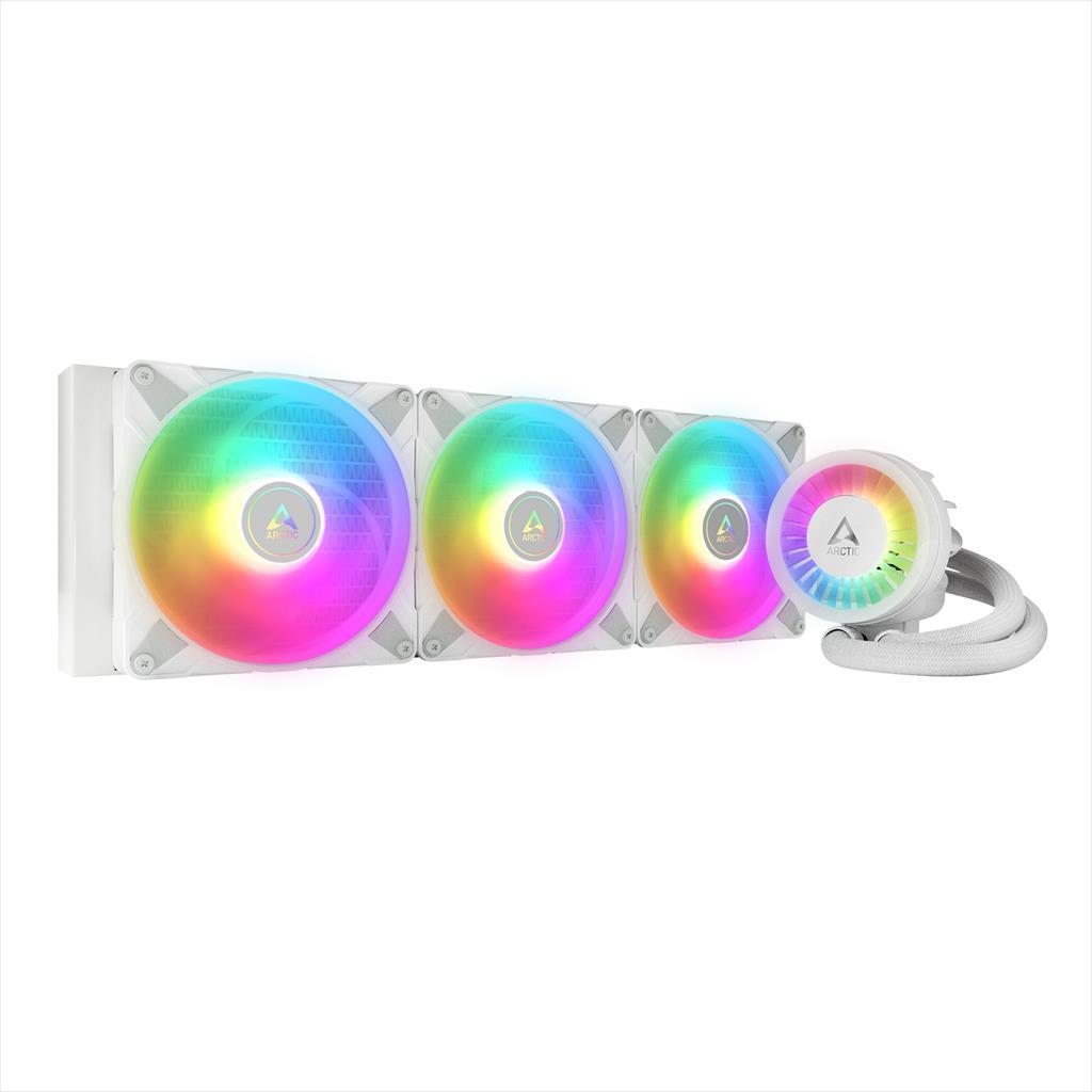

Model Name: ARCTIC LIQUID FREEZER III 420
- Compatibillity:
- Intel: 1700
- AMD: AM5, AM4
- PI | NNPI: 374 | 339
- TIM: MX-6 (0.8 g)
- Operating Ambient Temperature: 0—40 °C
- Weight: 2325 g
- LED Connector: 3-Pin A-RGB Connector
- All-In-One Connector: 4-Pin PWM Connector
- Splitt Connector: 3x 4-Pin PWM Connector

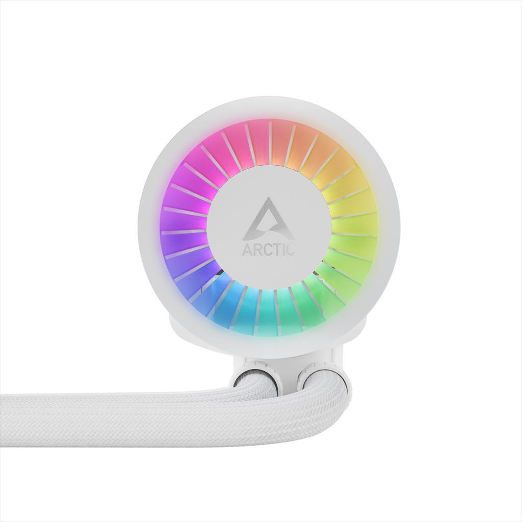

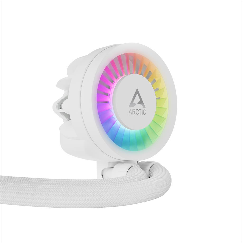

- Pump:
- Pump: 800—2800 rpm (PWM controlled)
- Current | Voltage: 0.35 A | 12 V DC
- Cold Plate: Copper, Micro Skived Fins
- Tube Length: 450 mm
- Tube Diameter: Outer: 12.4 mm, Inner: 6.0 mm
- Radiator:
- Material: Aluminium
- Dimensions: 458 (L) x 138 (W) x 38 (H) mm
- VRM Module:
- VRM Fan: 400—2500 rpm (PWM controlled)
- Current | Voltage: 0.05 A | 12 V DC
- LEDs:
- 12x A-RGB LEDs
- Current | Voltage: 0.40 A | 5 V DC
- Radiator Fans:
- Fan: 3x P14 PWM PST A-RGB
- Speed: 200—1900 rpm
- Air Flow: 69.90 cfm | 117.06 m3/h
- Static Pressure: 2.0 mmH2O
- Bearing: Fluid Dynamic Bearing
- Current | Voltage: 0.17 A | 12 V DC
- Cable Length: 40 mm
- Connector: 4-Pin PWM Connector
- RGB:
- LEDs: 12x A-RGB LEDs
- Current | Voltage: 0.40 V | 5 V DC
- Cable Length: 40 mm + 80 mm Splitter Cable
- Connector: 3-Pin A-RGB Connector + 3-Pin Plug
